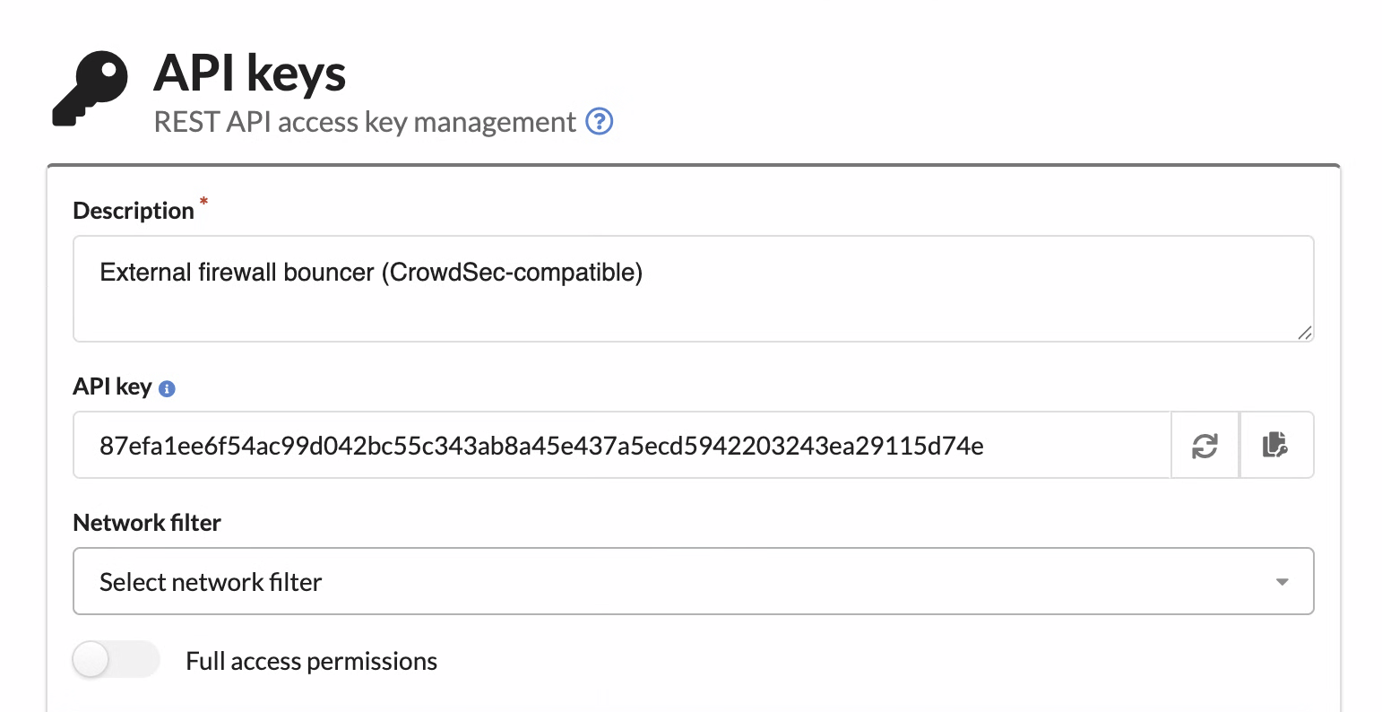

#### 1. Create an API token
1. Open **System → API keys**.
2. Click **Create bouncer token** (pre-fills the correct path restriction).
3. A token-creation form opens. The description ("External firewall bouncer (CrowdSec-compatible)") and the API key are pre-filled — optionally pick a **Network filter** to restrict the source IP the bouncer is allowed to call from. Leave **Full access permissions** off: the **Create bouncer token** button has already scoped the token to `/api/v3/firewall-bouncer`, so it has no access to the rest of the API.
<figure><img src="https://835495363-files.gitbook.io/~/files/v0/b/gitbook-x-prod.appspot.com/o/spaces%2FsZ8acWnNlSalIHQjMFu1%2Fuploads%2Fgit-blob-f3b0c030d2605d362bf7c89dbf160d2af7a2fb0c%2Fbouncer-token-form.png?alt=media" alt=""><figcaption><p>Token creation form with the description and key pre-filled</p></figcaption></figure>

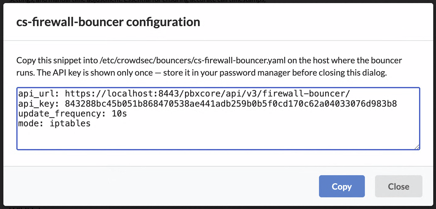

4. Save. A modal will pop up with a ready-to-paste `cs-firewall-bouncer.yaml` snippet — **copy it immediately**, the API key is shown only once.
<figure><img src="https://835495363-files.gitbook.io/~/files/v0/b/gitbook-x-prod.appspot.com/o/spaces%2FsZ8acWnNlSalIHQjMFu1%2Fuploads%2Fgit-blob-d5c5f2d0abe44c8b964026c387fe15b7dd8f5bec%2Fbouncer-token-preset.png?alt=media" alt=""><figcaption><p>Modal with the cs-firewall-bouncer preset config after creating the token</p></figcaption></figure>
