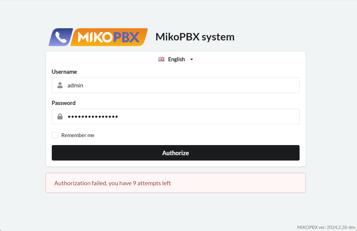

You may encounter a situation where you have forgotten the username or password for the MikoPBX web interface. This guide explains how to reset them.
<figure><img src="https://835495363-files.gitbook.io/~/files/v0/b/gitbook-x-prod.appspot.com/o/spaces%2FsZ8acWnNlSalIHQjMFu1%2Fuploads%2FkuDxbuz5l5I67paUnZr9%2FLoginError(MikoPBXEntryWEB).png?alt=media&amp;token=b64f60de-2b05-4fc5-840a-23d31cd2192d" alt=""><figcaption><p>Authorization failed</p></figcaption></figure>

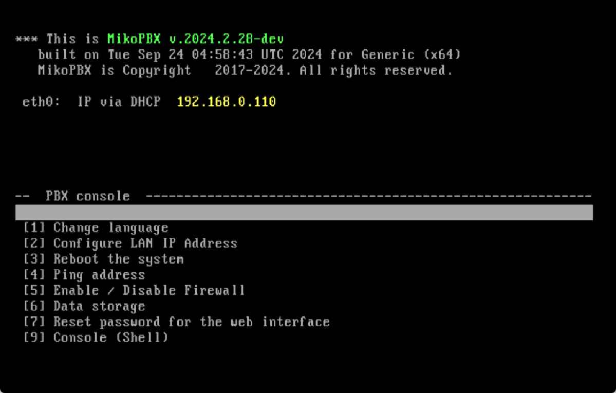

1. Go to the MikoPBX console.
The location of the console depends on the installation method:
* If installed on a physical server - on the monitor connected to the server.
* If installed in a virtual machine - in the virtual machine management console.
* If installed in the cloud - in the cloud serial console (also in the virtual machine management console).
* The reset method when installing in a Docker container is described in more detail in the current documentation.
In addition, the console can be accessed using SSH authorization. You can read more about SSH connection [here](/mikopbx/english/faq/troubleshooting/connecting-to-a-pbx-using-ssh.md).
To learn more about MikoPBX, please refer to the [following documentation](/mikopbx/english/readme/getting-to-know-mikopbx.md).
<figure><img src="https://835495363-files.gitbook.io/~/files/v0/b/gitbook-x-prod.appspot.com/o/spaces%2FsZ8acWnNlSalIHQjMFu1%2Fuploads%2FW2CK3gGUsVwEtIsWvRcL%2Fmikopbxconsole.png?alt=media&amp;token=8a5aaad9-b38e-41fb-aed7-d9248f43bdaf" alt=""><figcaption><p>MikoPBX Console</p></figcaption></figure>

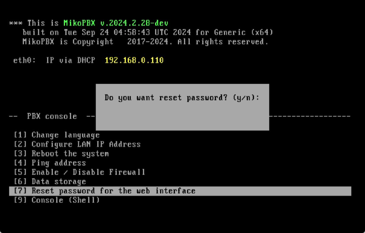

2. Select the option "**\[7] Reset password for the web interface**".
3. Type **y** to confirm resetting the login and password.
<figure><img src="https://835495363-files.gitbook.io/~/files/v0/b/gitbook-x-prod.appspot.com/o/spaces%2FsZ8acWnNlSalIHQjMFu1%2Fuploads%2FhubG9G9HNbHnnxEeMmEs%2FpasswordReset.png?alt=media&amp;token=d8a9254e-9a92-4726-8859-6ac6520c4864" alt=""><figcaption><p>Password reset confirmation</p></figcaption></figure>

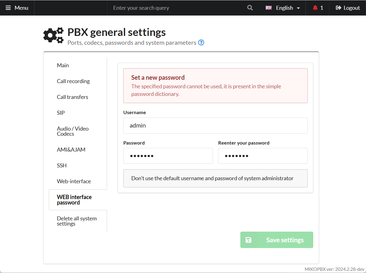

4. Log in to the web interface using the default credentials:
**Default web interface credentials:**
* **Username**: admin
* **Password**: admin
After the first login, you will be prompted to change the credentials.
<figure><img src="https://835495363-files.gitbook.io/~/files/v0/b/gitbook-x-prod.appspot.com/o/spaces%2FsZ8acWnNlSalIHQjMFu1%2Fuploads%2FN73txOxu7hgzIqErCSF9%2FchangeLoginAndPassword.png?alt=media&amp;token=a0a98f7e-aa1c-419a-866b-69a588438020" alt=""><figcaption><p>Changing your login information</p></figcaption></figure>
