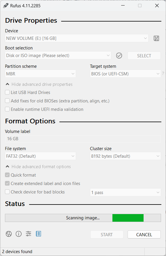

The image will be written using the Rufus utility. You can download it [here](https://rufus.ie/en/).
<figure><img src="https://835495363-files.gitbook.io/~/files/v0/b/gitbook-x-prod.appspot.com/o/spaces%2FsZ8acWnNlSalIHQjMFu1%2Fuploads%2FKjUBRmS8c9n8aMVcAD0S%2FrufusMainMenu.png?alt=media&amp;token=0d477122-9af0-4cc6-8c39-fe5cb411af22" alt="" width="285"><figcaption><p>Rufus main page</p></figcaption></figure>
The USB drive size must be at least 1 GB. **All data on the USB drive will be deleted!**
1. After installing the utility, open its interface. In the "**Device**" section, select your USB drive, click **SELECT**, and choose the previously downloaded [.iso image](https://www.mikopbx.com/download/). Its verification will begin.
<figure><img src="https://835495363-files.gitbook.io/~/files/v0/b/gitbook-x-prod.appspot.com/o/spaces%2FsZ8acWnNlSalIHQjMFu1%2Fuploads%2FNNMUKH6a35rMo98rsHGq%2FrefusSecletedDevice%26Image.png?alt=media&amp;token=fdf78c6c-3408-4c93-b3d9-d0cca94879c6" alt="" width="285"><figcaption><p>Selected image and disk</p></figcaption></figure>
2. Once verification is complete, set the following parameters and click **START**:
* **File system** - FAT32
* **Cluster size** - 8192 Bytes
* **Quick format** - checked
* **Create extended label and icon files -** **uncheck this option**
<figure><img src="https://835495363-files.gitbook.io/~/files/v0/b/gitbook-x-prod.appspot.com/o/spaces%2FsZ8acWnNlSalIHQjMFu1%2Fuploads%2FpdCmKQ0kXn1xSUaKm2bi%2FrufusStartButton.png?alt=media&amp;token=0dbfc190-3007-4c3a-9f56-4e91a2ac89d1" alt="" width="285"><figcaption><p>Starting the image writing process</p></figcaption></figure>

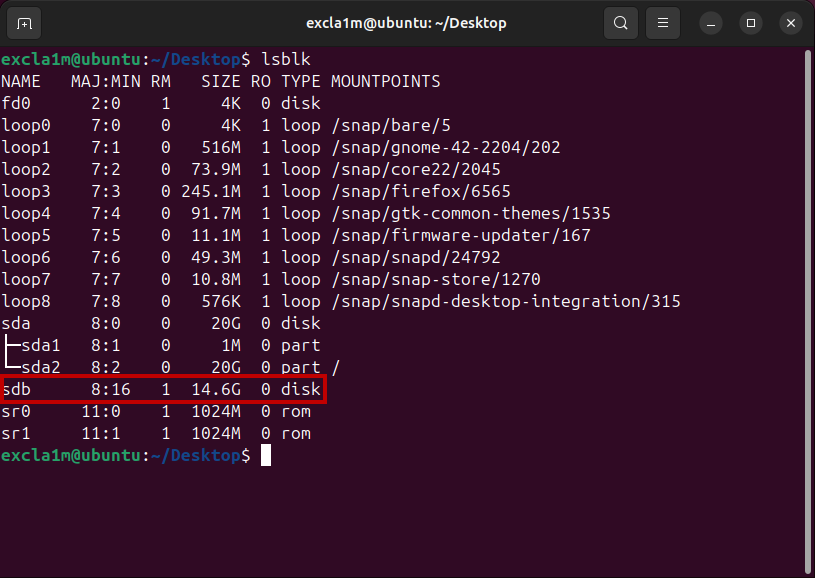

lsblk
This will display information about all connected drives.\
Find your USB drive in the list and remember its name. In our example, it is **sdb**.
<figure><img src="https://835495363-files.gitbook.io/~/files/v0/b/gitbook-x-prod.appspot.com/o/spaces%2FsZ8acWnNlSalIHQjMFu1%2Fuploads%2Fs1BOv4nfoTO7gloDkc2J%2FlsblkCommand.png?alt=media&amp;token=21fb55bc-00b6-44c5-9cb9-cc14c1bfa152" alt=""><figcaption><p>lsblk command</p></figcaption></figure>

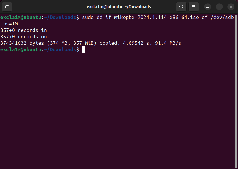

5. Write the image to the USB drive using this command:
```bash
sudo dd if=mikopbx-2024.1.114-x86_64.iso of=/dev/sdb bs=1M
Wait until the writing process is complete. Then proceed to the section ["System installation"](#system-installation).
<figure><img src="https://835495363-files.gitbook.io/~/files/v0/b/gitbook-x-prod.appspot.com/o/spaces%2FsZ8acWnNlSalIHQjMFu1%2Fuploads%2FJG13DSUHukKqrtZYR3b1%2FsuccessfulWritedImage(Ubuntu).png?alt=media&amp;token=f6ffcebb-67b4-4b27-825b-0533dda2dd66" alt=""><figcaption><p>Successfully writed image</p></figcaption></figure>
