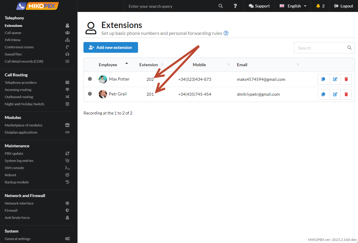

In MikoPBX (***Telephony → Employees***), the following employee accounts are configured:
<figure><img src="https://835495363-files.gitbook.io/~/files/v0/b/gitbook-x-prod.appspot.com/o/spaces%2FsZ8acWnNlSalIHQjMFu1%2Fuploads%2FU9eMD8FZLPDSaHGHoW1E%2Fextensions.png?alt=media&amp;token=fc206194-3562-4541-b0bc-aede2fb4c932" alt=""><figcaption><p>Section "Extensions"</p></figcaption></figure>

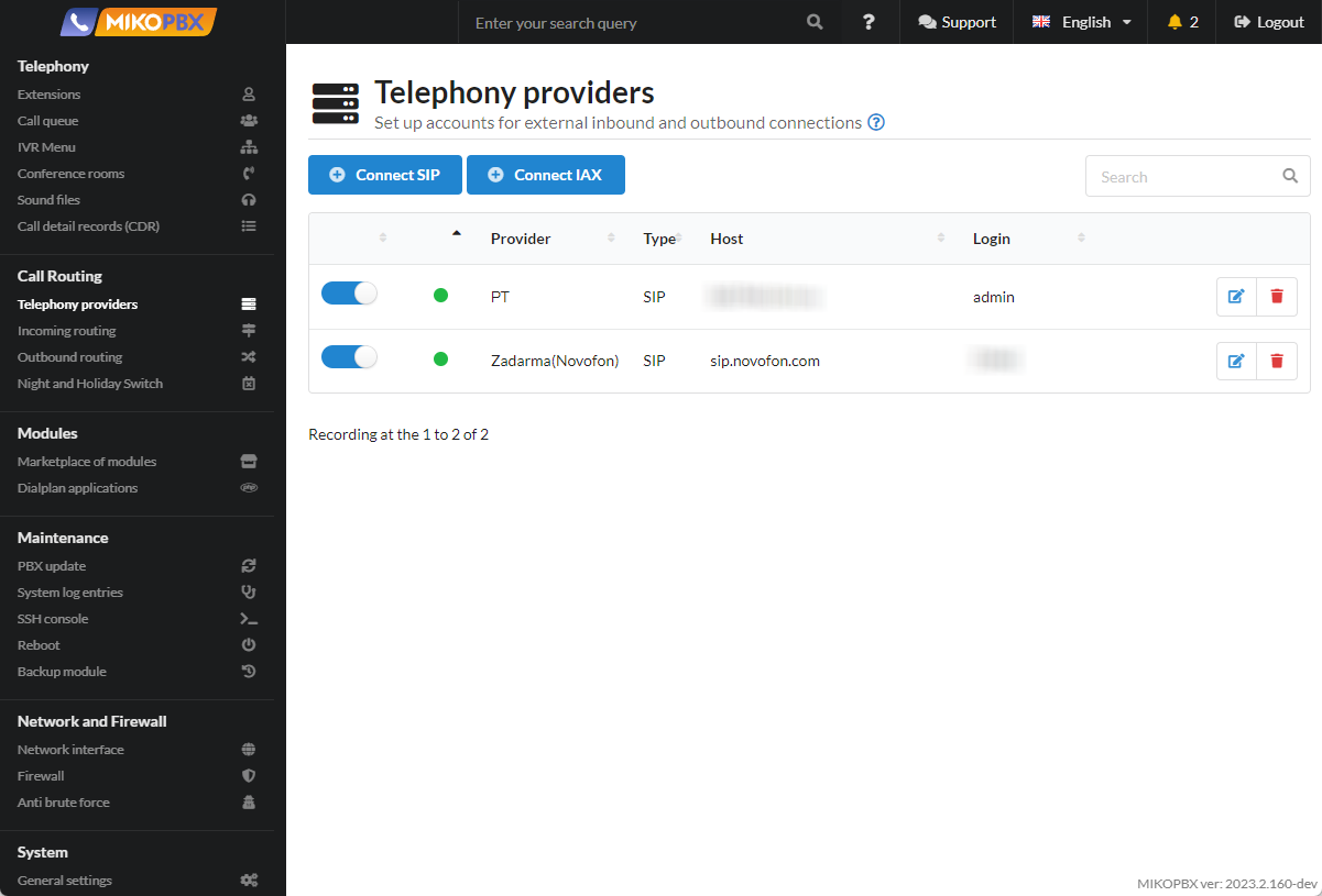

In MikoPBX, there are **two providers** configured (***Routing → Telephony Providers***):

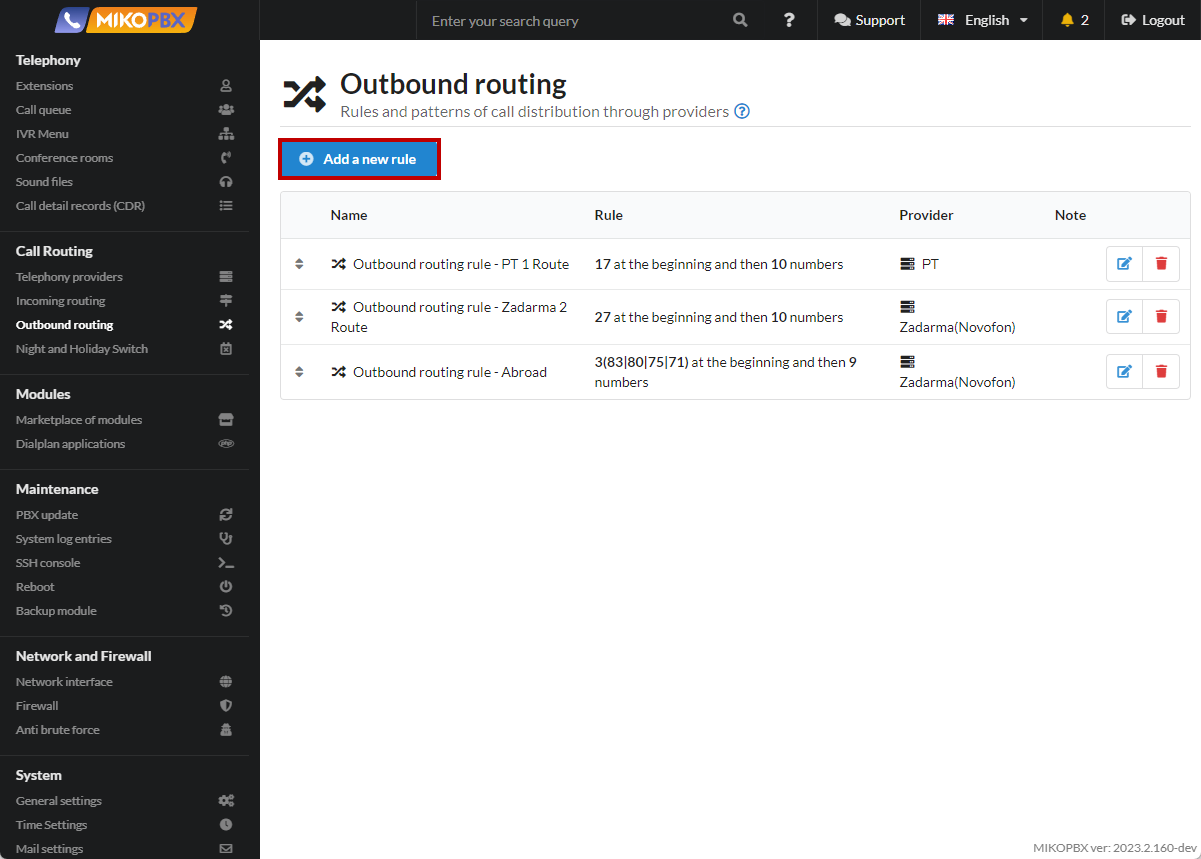

1. For the **first** provider, create an outbound rule. Go to **Routing** → **Outbound Routes**. Add a new rule.

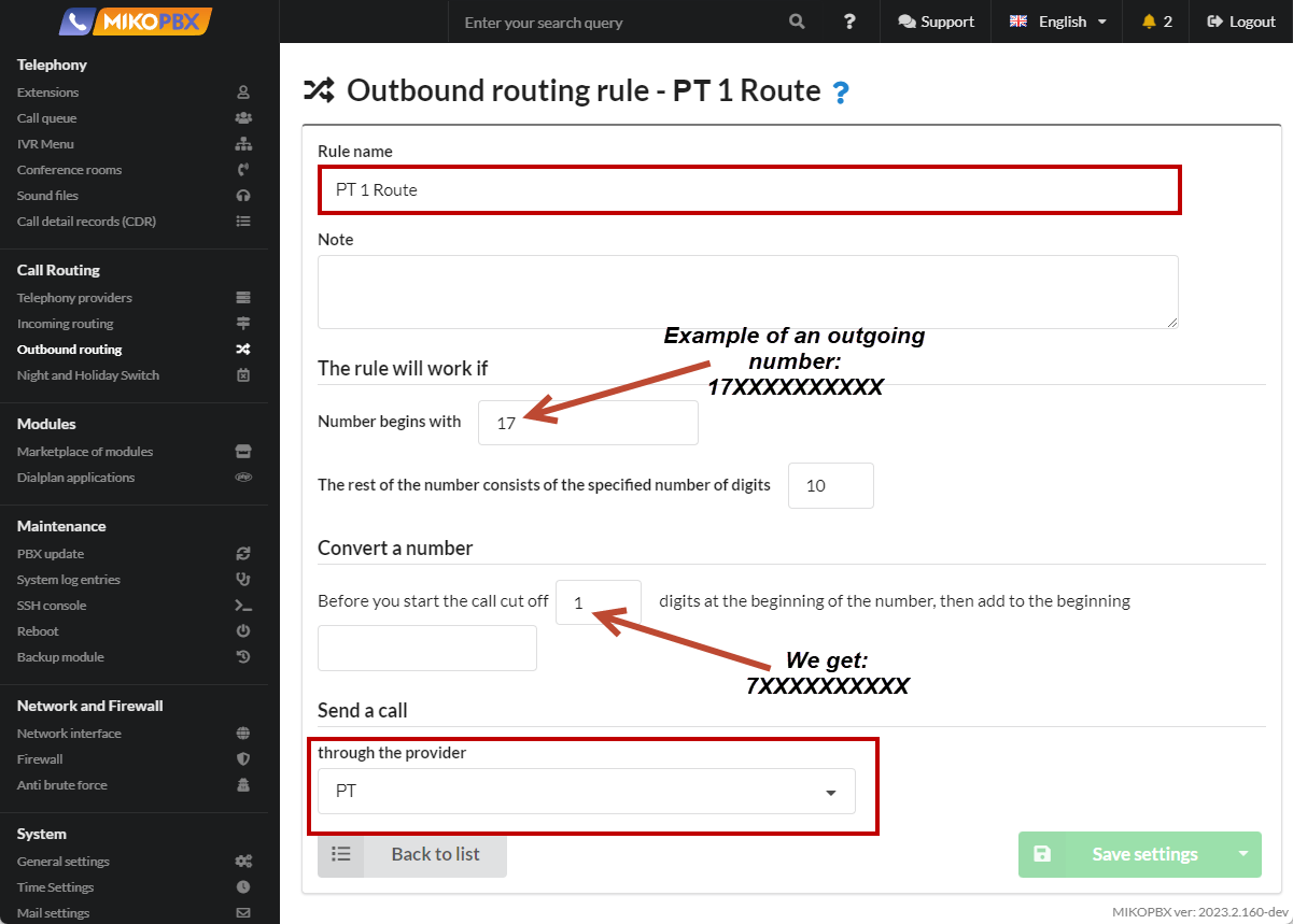

2. Fill in the parameters as shown in the screenshot below:
<figure><img src="https://835495363-files.gitbook.io/~/files/v0/b/gitbook-x-prod.appspot.com/o/spaces%2FsZ8acWnNlSalIHQjMFu1%2Fuploads%2FBH0phYbUomZ6E25V56OG%2FfirstProvider.png?alt=media&amp;token=d4560160-1c82-439d-9508-9826653f7816" alt=""><figcaption><p>Routing parameters for the first provider</p></figcaption></figure>

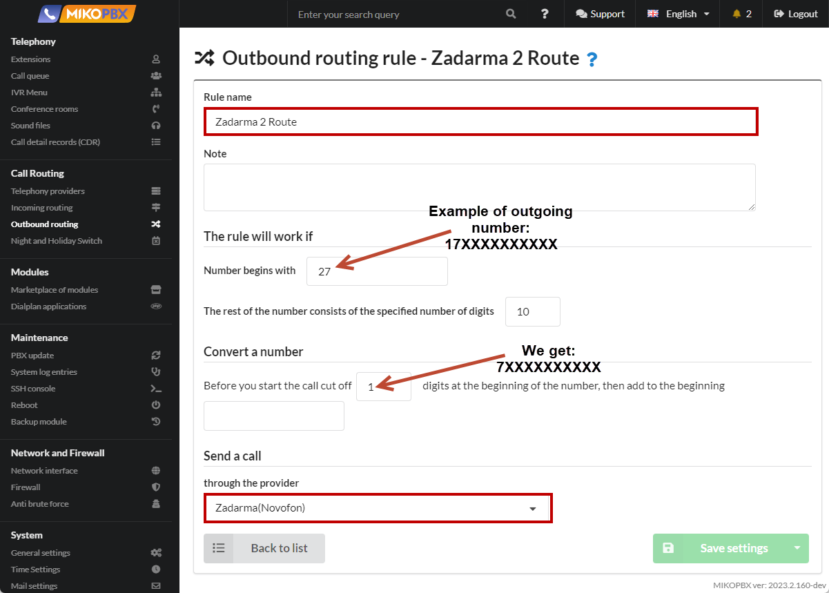

3\. For the **second** Zadarma provider, we create an outgoing rule. Go to the **Routing** → **Outgoing routes** section. Adding a new rule as in the screenshot below:
<figure><img src="https://835495363-files.gitbook.io/~/files/v0/b/gitbook-x-prod.appspot.com/o/spaces%2FsZ8acWnNlSalIHQjMFu1%2Fuploads%2FOi1x7WZirXDqN3MZ4O9A%2FsecondProvider.png?alt=media&amp;token=f25daed8-5baf-4c0d-923e-9d7fac7e77d8" alt=""><figcaption><p>Routing parameters for the second provider</p></figcaption></figure>

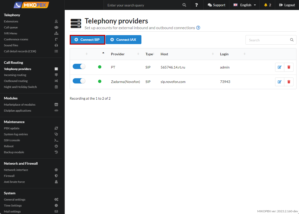

2. In the **Routing** → **Telephony Providers** section, add a third provider account.
<figure><img src="https://835495363-files.gitbook.io/~/files/v0/b/gitbook-x-prod.appspot.com/o/spaces%2FsZ8acWnNlSalIHQjMFu1%2Fuploads%2FZQGTOtA5xogphNjKMUbW%2FnewProvider.png?alt=media&amp;token=a66fbfa7-6b6a-4280-bdb5-cfccbba58dd8" alt=""><figcaption><p>New Provider</p></figcaption></figure>

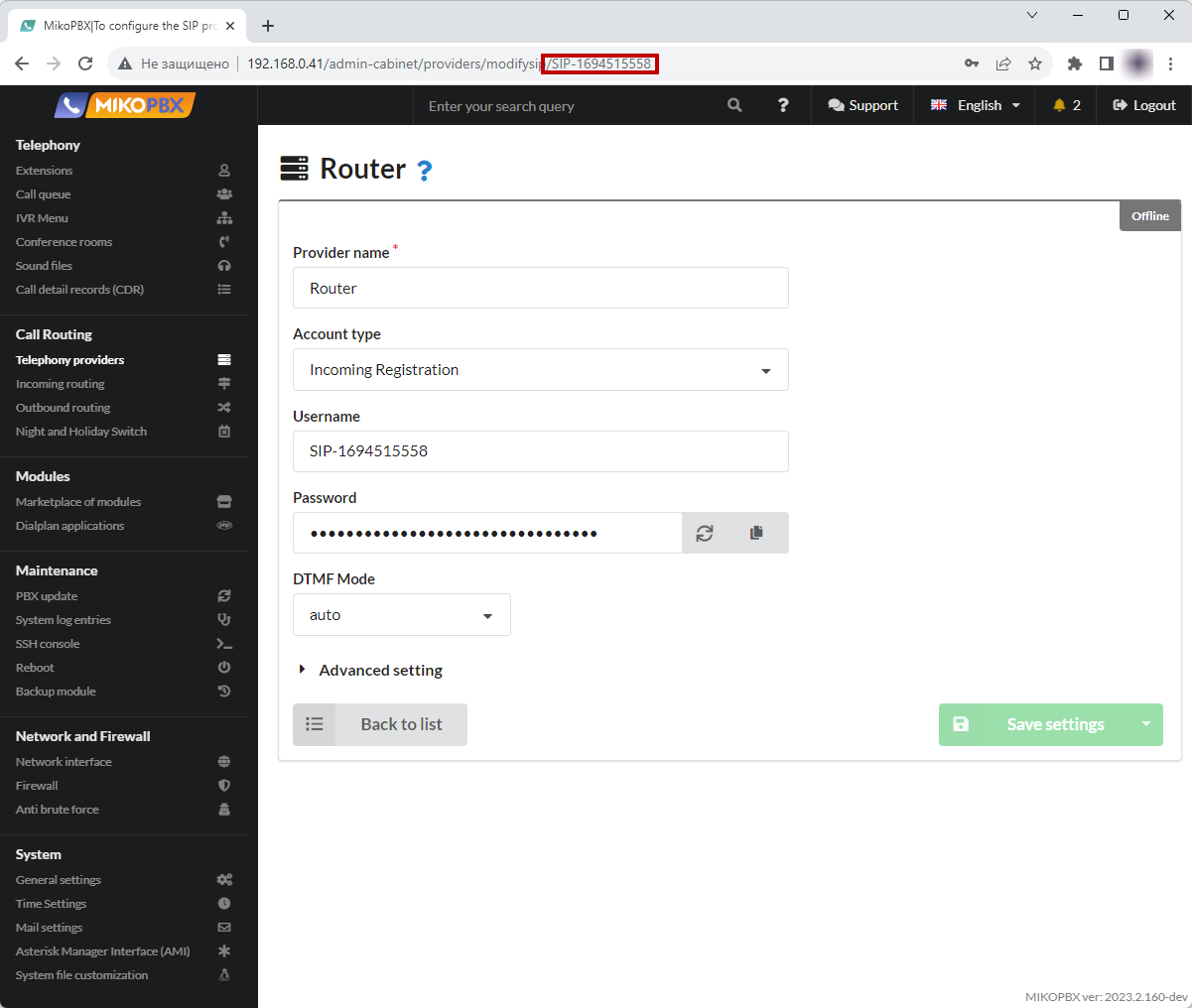

3. Fill in the parameters as shown in the screenshots below:
<figure><img src="https://835495363-files.gitbook.io/~/files/v0/b/gitbook-x-prod.appspot.com/o/spaces%2FsZ8acWnNlSalIHQjMFu1%2Fuploads%2FqpUmpQ8k79LoZpTaQ2un%2FsettingsOfProvider1.png?alt=media&amp;token=99045c85-0a51-4378-86e2-da3bf282f0fc" alt=""><figcaption></figcaption></figure>
<figure><img src="https://835495363-files.gitbook.io/~/files/v0/b/gitbook-x-prod.appspot.com/o/spaces%2FsZ8acWnNlSalIHQjMFu1%2Fuploads%2FgFYJKm2jAhFFgkWP4mYq%2FsettingsOfProvider2.png?alt=media&amp;token=0e6c44be-eb69-49eb-83c9-a463f7317bba" alt=""><figcaption><p>Router Parameters</p></figcaption></figure>
4. Save the account and copy the ID of this provider in the address bar.

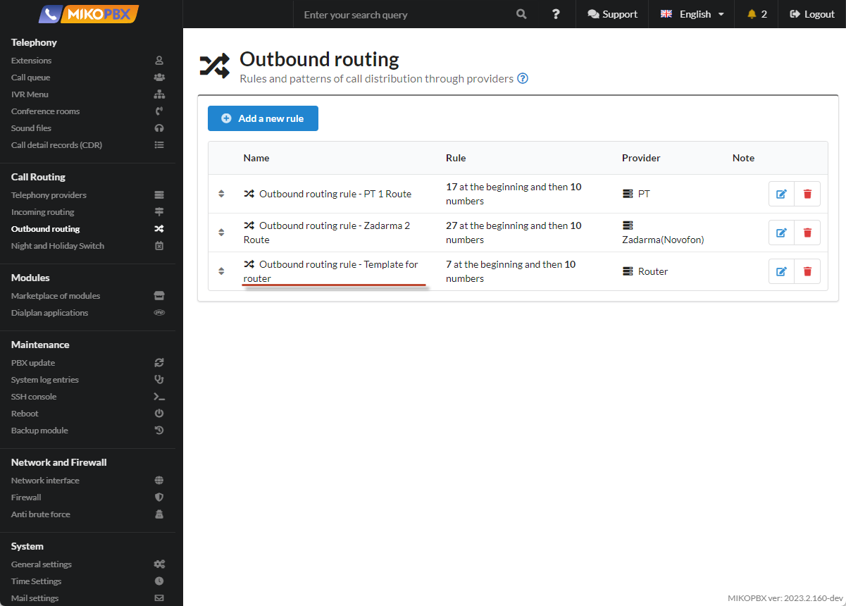

5. Add an **outgoing rule** for the created provider. By default, we will direct all calls through this provider, so be careful when creating an outgoing template. Calls through our providers can be made to numbers starting with 7, so our template takes the form:
<figure><img src="https://835495363-files.gitbook.io/~/files/v0/b/gitbook-x-prod.appspot.com/o/spaces%2FsZ8acWnNlSalIHQjMFu1%2Fuploads%2FL87MVSKVA5MeNEwvD7Pa%2FtemplateForRouter.png?alt=media&amp;token=18aa94ee-6e43-493d-9eb0-df67a8e4c9f8" alt=""><figcaption><p>Routing Parameters for Router</p></figcaption></figure>
6. Please note that the priority of the outgoing rule for the Router provider should be **lower** than all!
<figure><img src="https://835495363-files.gitbook.io/~/files/v0/b/gitbook-x-prod.appspot.com/o/spaces%2FsZ8acWnNlSalIHQjMFu1%2Fuploads%2Fe9OPvCIqGikv1k2TUocD%2FpriorityInOutboundRouting.png?alt=media&amp;token=55f5af4b-4cbe-4d77-a69f-dcde0dc3a87c" alt=""><figcaption><p>Priority in outbound routing</p></figcaption></figure>

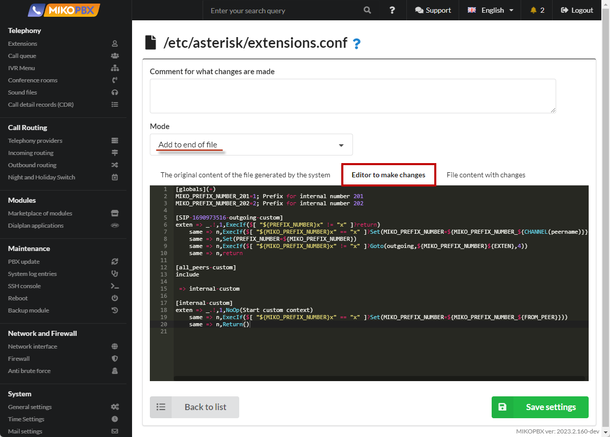

7. Go to **System** -> **System file customization** section
<figure><img src="https://835495363-files.gitbook.io/~/files/v0/b/gitbook-x-prod.appspot.com/o/spaces%2FsZ8acWnNlSalIHQjMFu1%2Fuploads%2Fn06cIfMIqk6wJhcxD3gW%2FSystemFileCustomization.png?alt=media&amp;token=4edfbfbf-6903-46c5-b1b5-d2a62131f59e" alt=""><figcaption><p>"System file customization" section</p></figcaption></figure>
8. Open the **extensions.conf** configuration file for editing.
<figure><img src="https://835495363-files.gitbook.io/~/files/v0/b/gitbook-x-prod.appspot.com/o/spaces%2FsZ8acWnNlSalIHQjMFu1%2Fuploads%2FNuELWVzuFh5rThr08jvu%2FEditExtensions.conf.png?alt=media&amp;token=567dc075-00ed-45a7-bc10-915ccc1dc97f" alt=""><figcaption><p>"extensions.conf" file</p></figcaption></figure>
9. Select the "**Add to end of file**" mode. In the editing window, insert the following lines:
[globals](+)
MIKO_PREFIX_NUMBER_201=1; Prefix for internal number 201
MIKO_PREFIX_NUMBER_202=2; Prefix for internal number 202
[SIP-1690973516-outgoing-custom]
exten => _.!,1,ExecIf($[ "${PREFIX_NUMBER}x" != "x" ]?return)
    same => n,ExecIf($[ "${MIKO_PREFIX_NUMBER}x" == "x" ]?Set(MIKO_PREFIX_NUMBER=${MIKO_PREFIX_NUMBER_${CHANNEL(peername)}}))
    same => n,Set(PREFIX_NUMBER=${MIKO_PREFIX_NUMBER})
    same => n,ExecIf($[ "${MIKO_PREFIX_NUMBER}x" != "x" ]?Goto(outgoing,${MIKO_PREFIX_NUMBER}${EXTEN},4))
    same => n,return
[all_peers-custom]
include
 => internal-custom
[internal-custom]
exten => _.!,1,NoOp(Start custom context)
    same => n,ExecIf($[ "${MIKO_PREFIX_NUMBER}x" == "x" ]?Set(MIKO_PREFIX_NUMBER=${MIKO_PREFIX_NUMBER_${FROM_PEER}}))
    same => n,Return()
In the code snippet above, you need to create the correct context name.\
The format of the created context:
[PROVIDER-ID-outgoing-custom]
**PROVIDER-ID** - the value you saved in the third step described in this method. In our example, it's **SIP-1690973516**.
